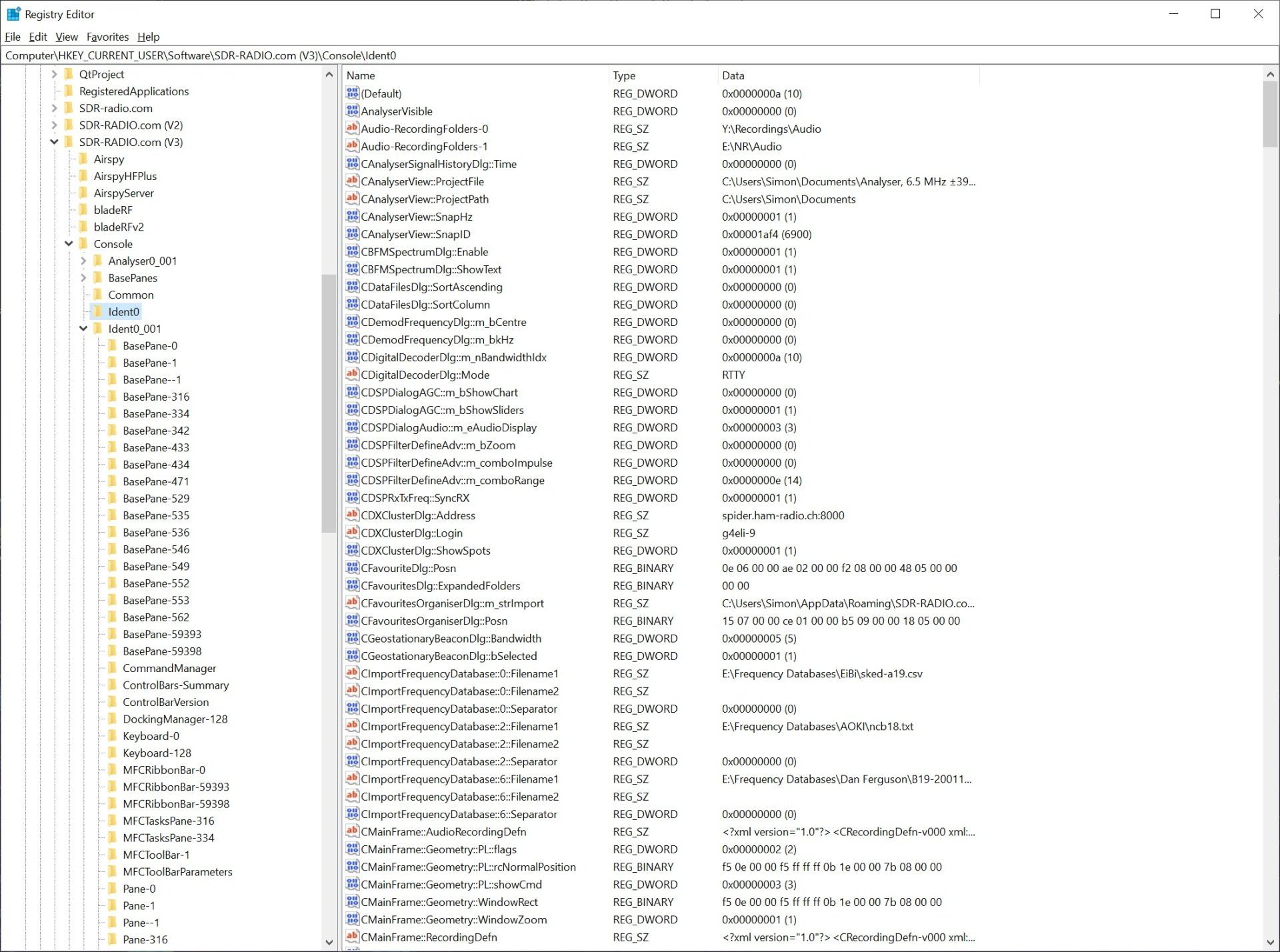

Registry
User settings for the Main identity are store in the registry path:
  • HKEY_CURRENT_USER\Software\SDR-RADIO.com (V3)\Console\Ident0 (see below).
The layout is stored in:
  • HKEY_CURRENT_USER\Software\SDR-RADIO.com (V3)\Console\Ident0_001.
Do not edit the registry! You can remove these folders if resetting your SDR Console identity or removing SDR Console from your computer.
