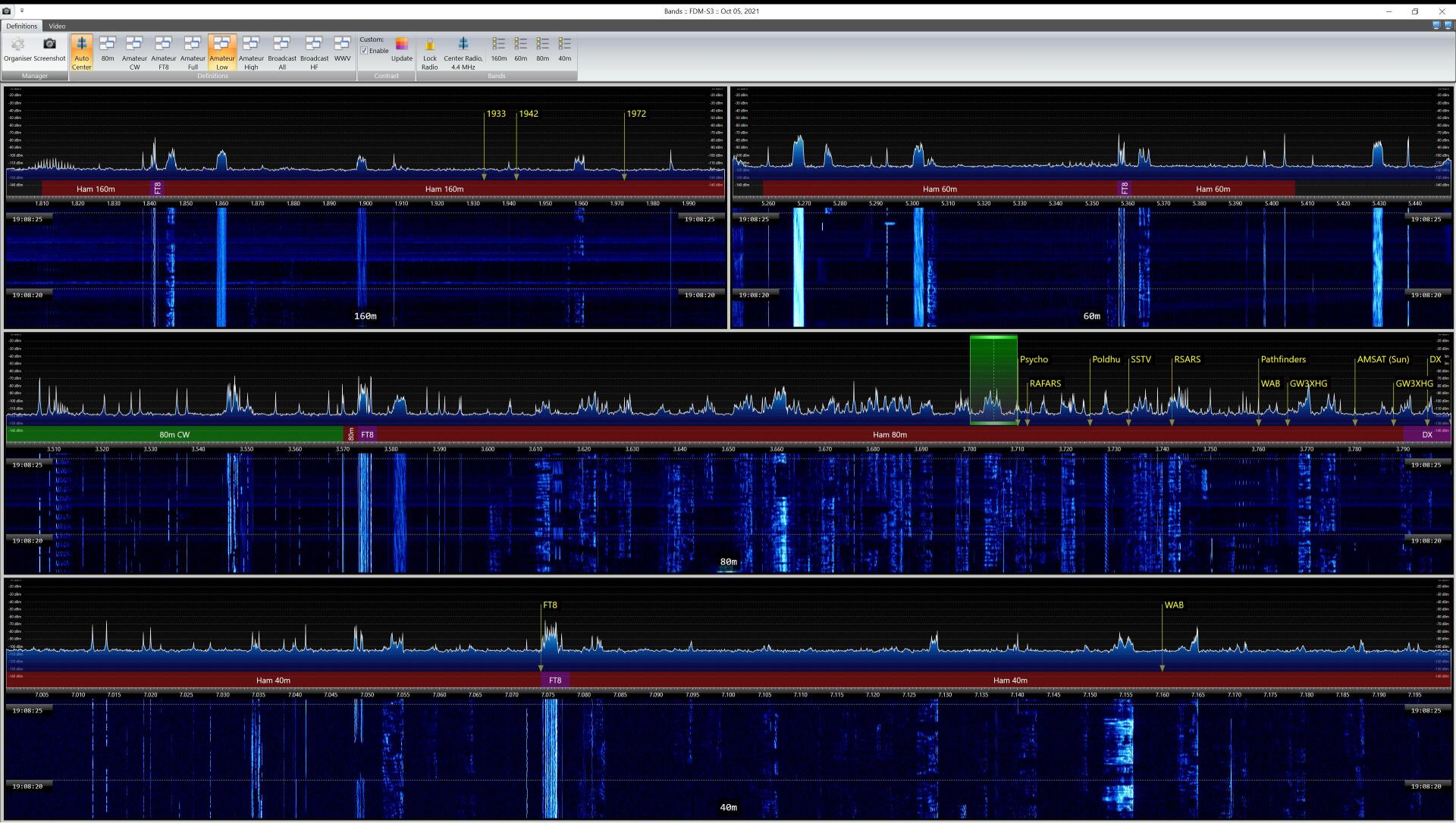

October 6th 2021: The multi-band display is used to display one or more bands simultaneously, for example:
- HF broadcast bands,
- HF Amateur bands,
- FT8 segments,
- 144MHz split into 4 sub-bands.
The band windows support:
- Changing the current receiver frequency with the mouse (click, scroll, drag),
- Band plan,
- Markers.

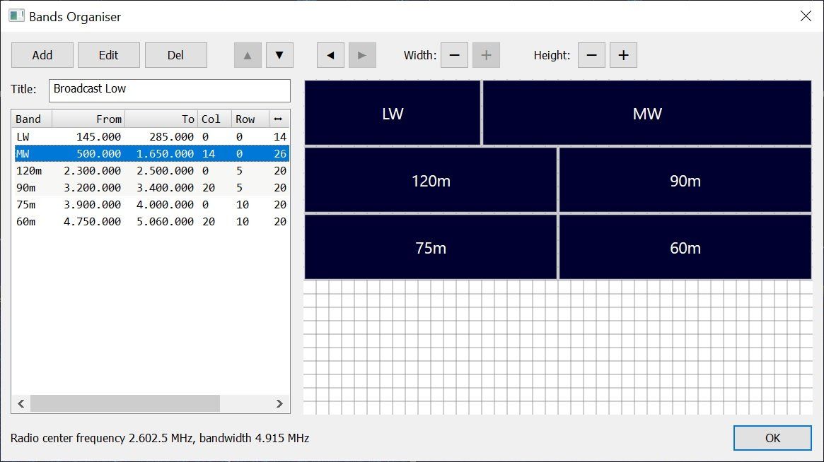

Manager
Organiser
This is where you create the definitions. Each definition has at least one and no more than twenty bands. Band ranges can overlap.
Each band definition contains:
- Title,
- Frequency range,
- Position in the layout window.
