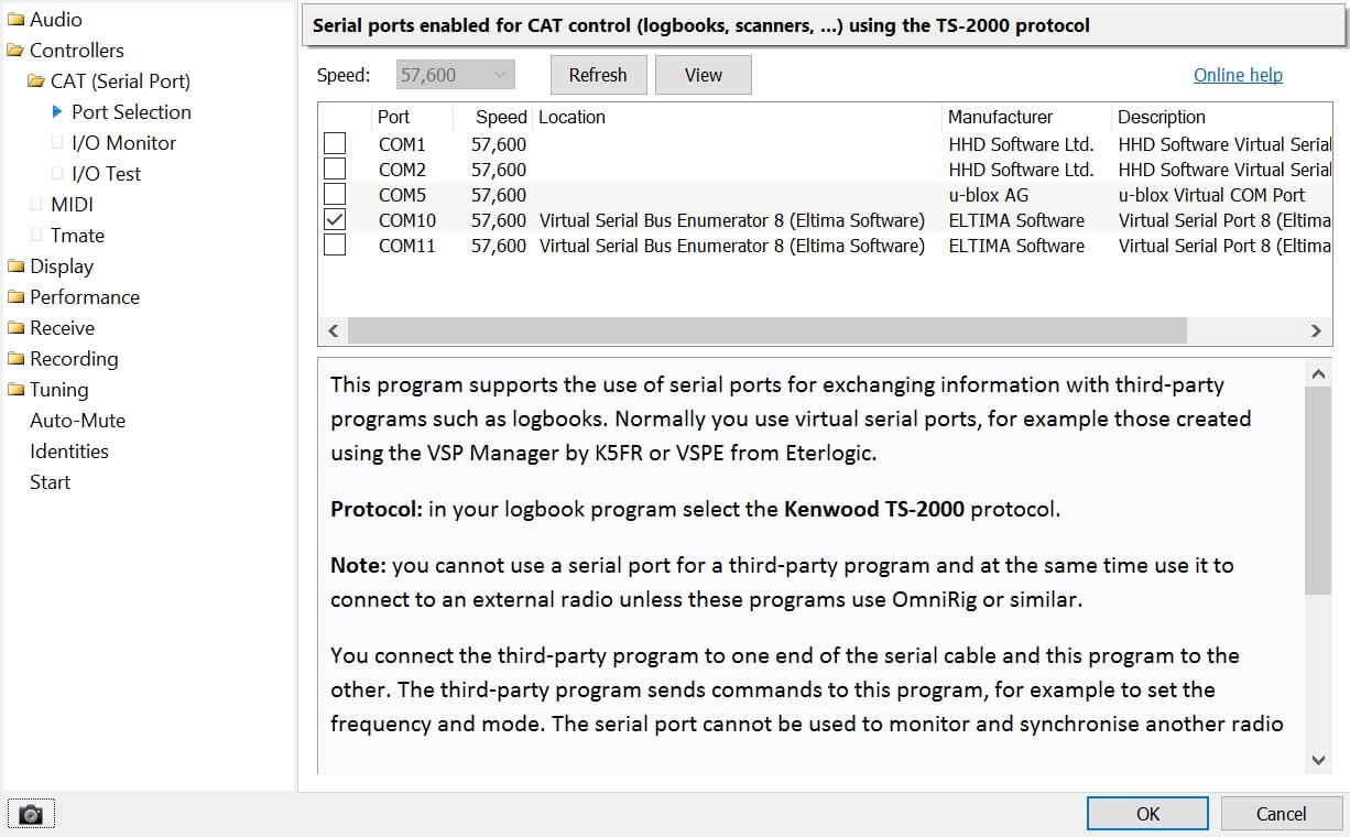

Connecting
You connect the third-party program (for example WSJT-X) to one end of the serial cable and this program (SDR Console) to the other. The third-party program sends commands to this program, for example to set the frequency and mode. The serial port cannot be used to monitor and synchronise another radio.
Protocol: in your logbook program select the Kenwood TS-2000 protocol.
Speed: If you are using a virtual serial port the default speed of 57,600 can be used, if using a hardware port then the speed must match the speed at the other end of the connection. To change the speed you first select an entry in the list and then select the new speed from the dropdown at the top of the window.
In the program options select Port Selection. In this window you select the ports which are opened by this program. This program opens and closes ports as you make changes to the selections in this window. The status is shown in the main logfile window.
Note:
you cannot use a serial port for a third-party program and at the same time use it to connect to an external radio unless these programs use Omni-Rig or similar. Use one serial port per program.

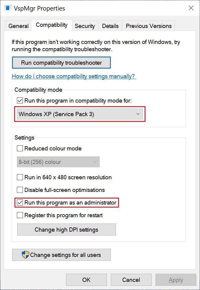

Important
Set compatibility to Windows XP SP3 and select 'Run as Administrator'.
The Help link does not work, this software does not appear to be maintained but does work well with Windows 10. The latest version appears to be 1.0.3.01.

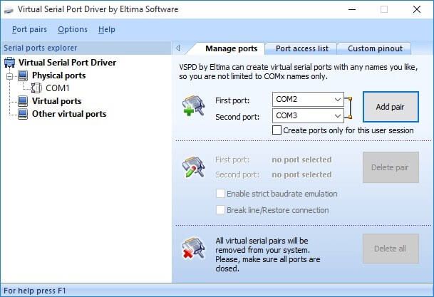

Virtual Serial Port Driver
Eltima Software
Create pairs of virtual COM ports linked by virtual null-modem cable
Virtual COM Port Driver is a powerful technology designed specifically for those who develop, test, or debug serial port software and hardware. This solution will provide your system with as many virtual COM interfaces as you need.

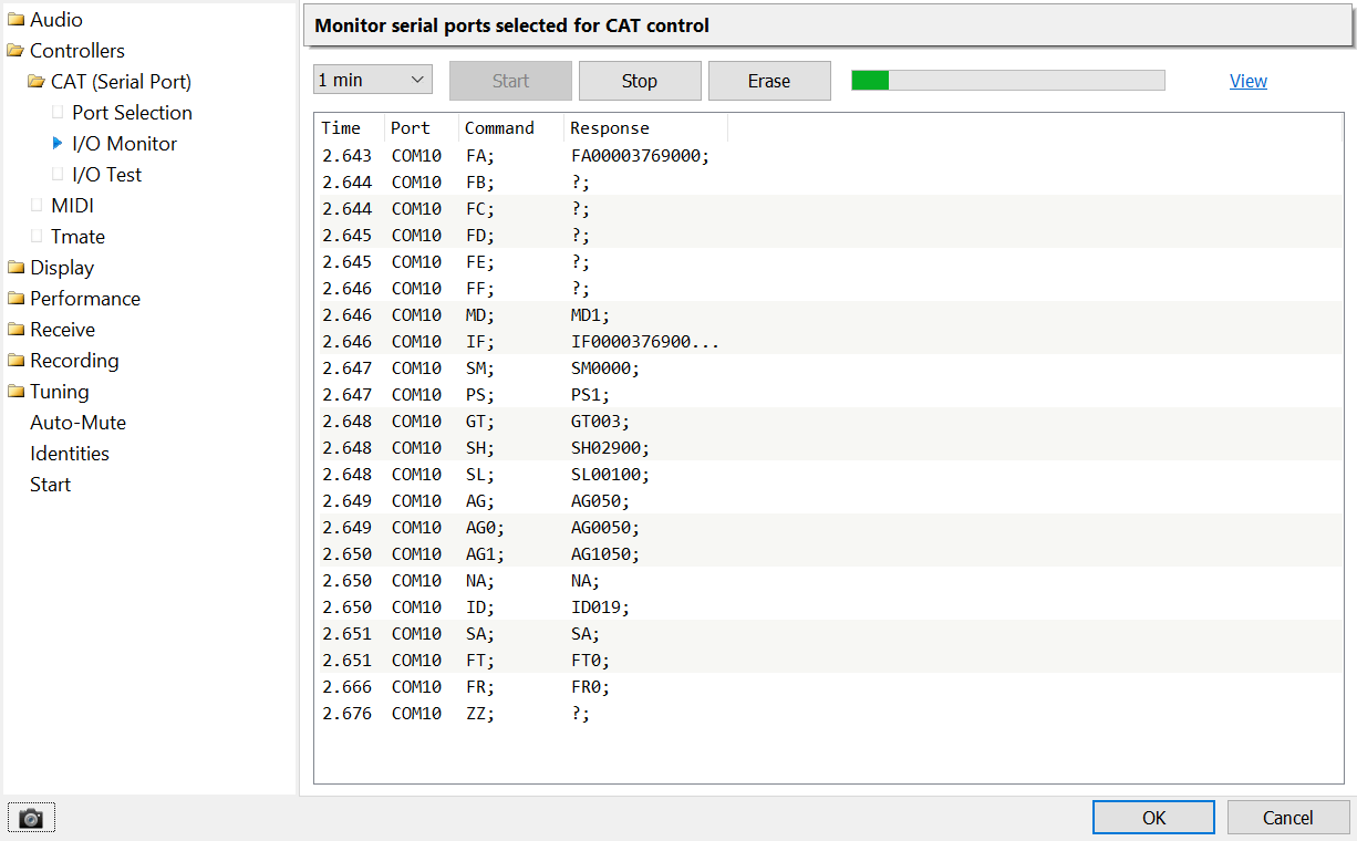

Use the I/O Monitor window to record and diagnose the serial port traffic. The View option displays the logfile with your default text file viewer. When enabled diagnostic information is also generated, this is displayed with DebugView - see http://www.sdr-radio.com/Support/Diagnostics for information about DebugView.
Using these extra diagnostics helps in the rare situations where a lockup may occur.

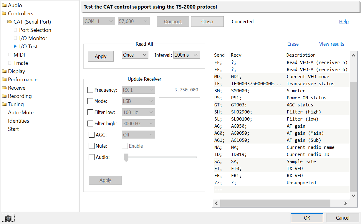

Testing
Use the I/O test window to verify the serial port protocol. It is recommended to use a second instance and identity of SDR Console for tests.
Connect to the other end of the virtual serial cable, then use Read All / Apply to return the values for the current receiver. The response should always be instantaneous.
Change Frequency
To change the frequency:
  • Check the Frequency box
  • Enter new value in Update Receiver window
  • Press Apply.

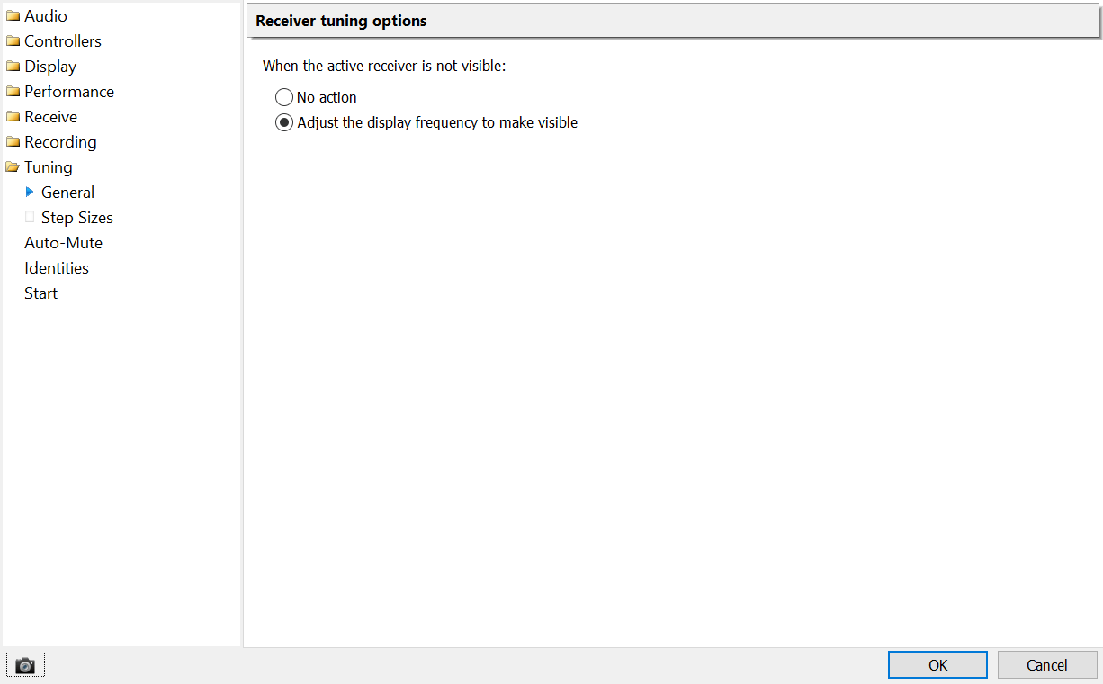

Band Switching
When you change the frequency of the active receiver, the frequency range (band) in the main waterfall will only change if the corresponding option is enabled in the Receiver tuning options below.

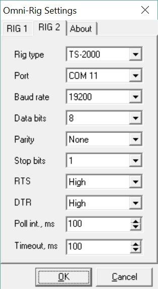

Omni-Rig
If you are using Omni-Rig set the timeout to 100ms (the lowest value supported).
The above image shows the recommended Omni-Rig settings, remember to select the correct Port, COM 11 is used as example.
