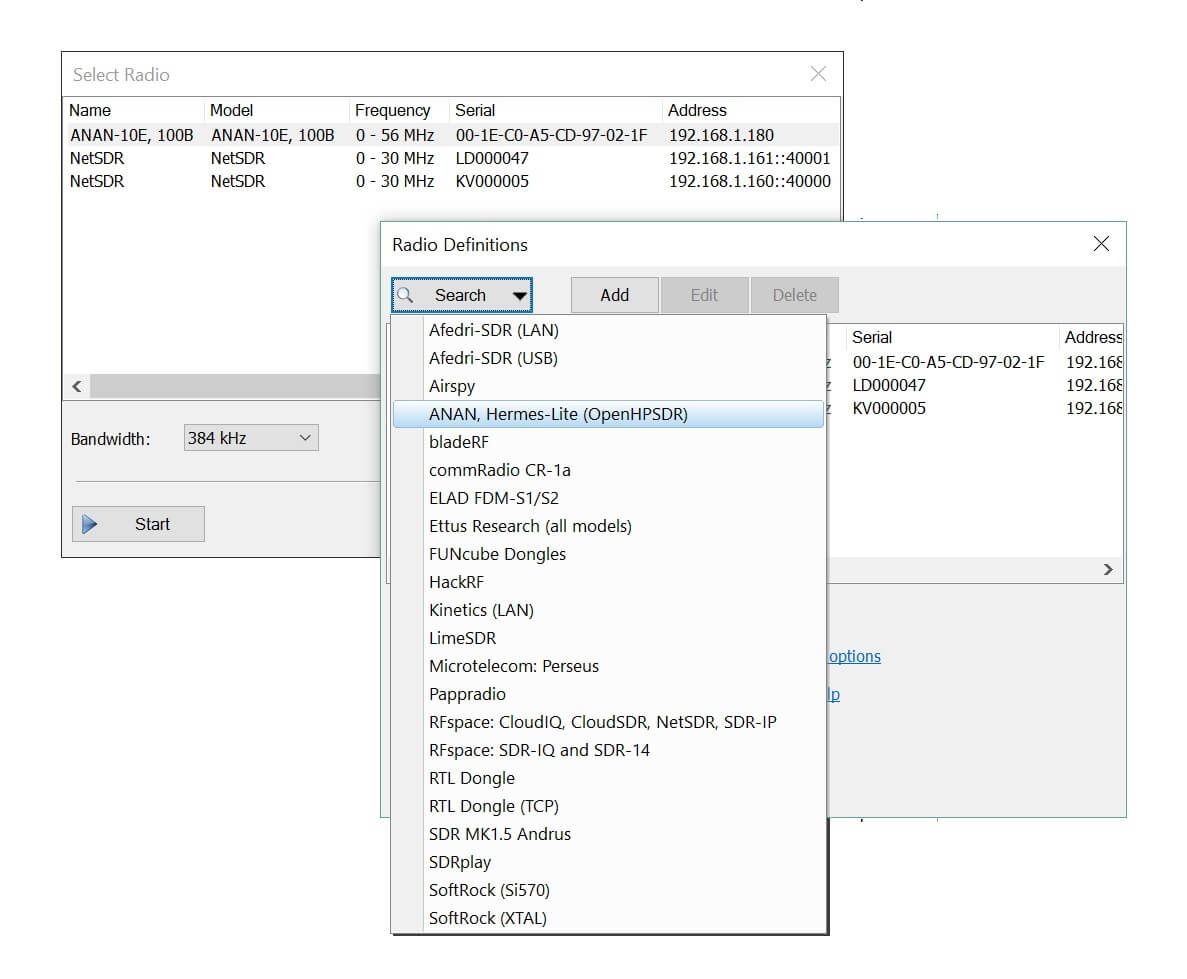

Detecting
When you search for ANAN hardware select ANAN (OpenHPSDR) from the dropdown list. If ANAN hardware is not found look in the logfile (below).
The ANAN hardware must have the correct Protocol II firmware loaded and be on the supported list.
An excerpt from a logfile with a non-supported ANAN model is shown below, in this case the hardware is actually the 8000DLE!

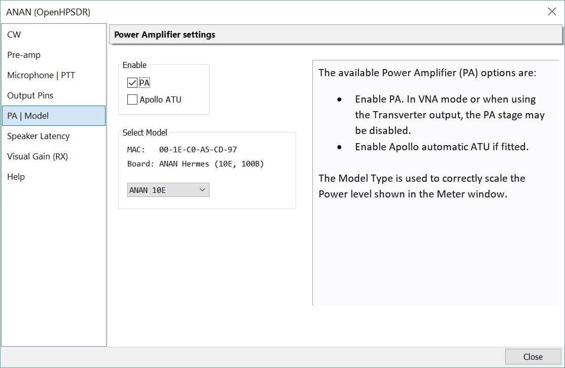

First Time
When you start an ANAN radio for the first time you must select the correct model in the PA ! Model page of the options. If your model is not shown here, please contact support and it'll be added.

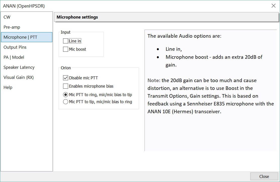

Microphone
There are two microphone selections:
  1. Connected to your computer, for example via USB or a sound card,
  2. Connected to the ANAN hardware.
You can also use a virtual audio cable, for example when interface to digital mode software. The microphone of choice is the RØDE NT1-A connected to the ANAN via a small Behringer mixer desk. The RØDE is a superb condenser microphone.
The ANAN microphone and PTT are below, note the optional microphone boost.

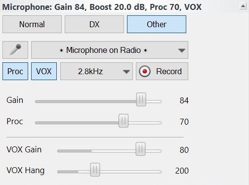

Gain
The gain of the transmit stages can be different for each band, so you have master gain settings [link] as well as the options shown in the Transmit DSP window.
With processing unselected, just the Gain slider to the audio is shown more-or-less as below, then apply processing to increase the waveform. The processing uses an advanced dynamic range compression algorithm (a multi-band compression will be offered later).
Drive
The drive slider directly sets the power output from the radio, the measured power is shown in Meter area. If the value in the ALC meter is in the red area then you a generating well-modulated audio.

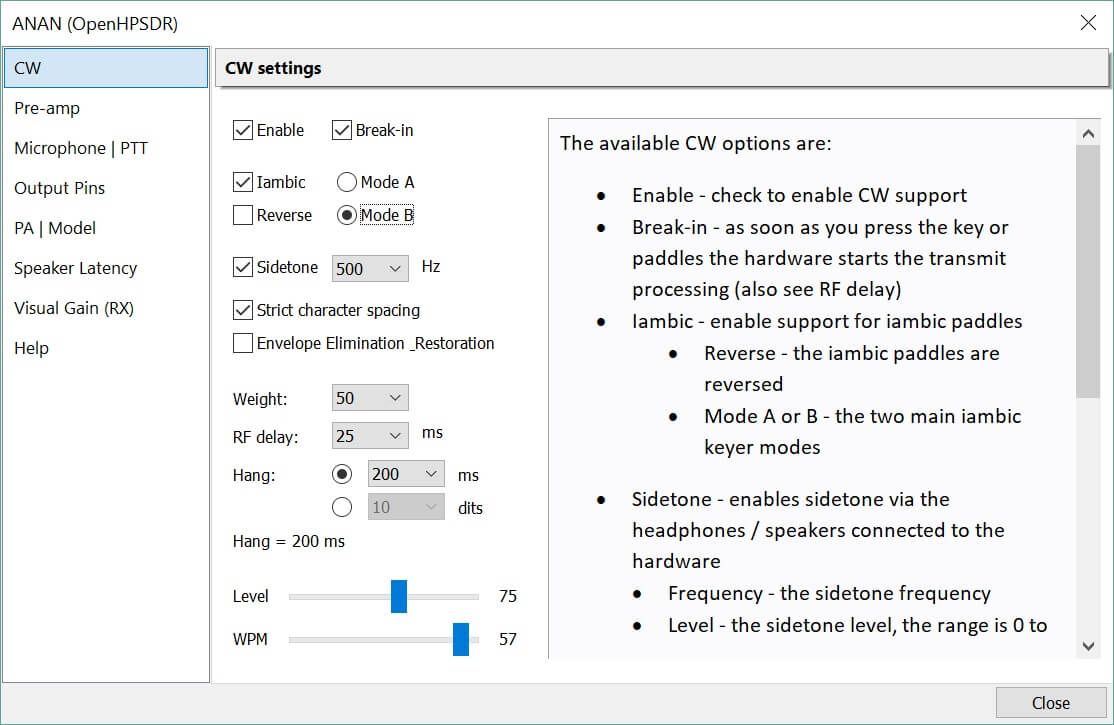

Options
The ANAN's own CW settings are selected from the Radio Configuration option (ribbon bar, Home, radio); this is available after you start the radio. The ANAN hardware has a built-in iambic keyer which works very well, you may prefer to use an external keyer such as a K1EL unit.
  • Internal: Enable Iambic, Mode B is the usual selection.
  • External: Disable Iambic.
Set the RF delay so the transmission only starts after relays in your amplifier / ATU ... have settled.
Select a suitable Hang time - this usually depends on the speed with which you send CW. Select the time either in ms or as a number of dits if using the internal keyer.
