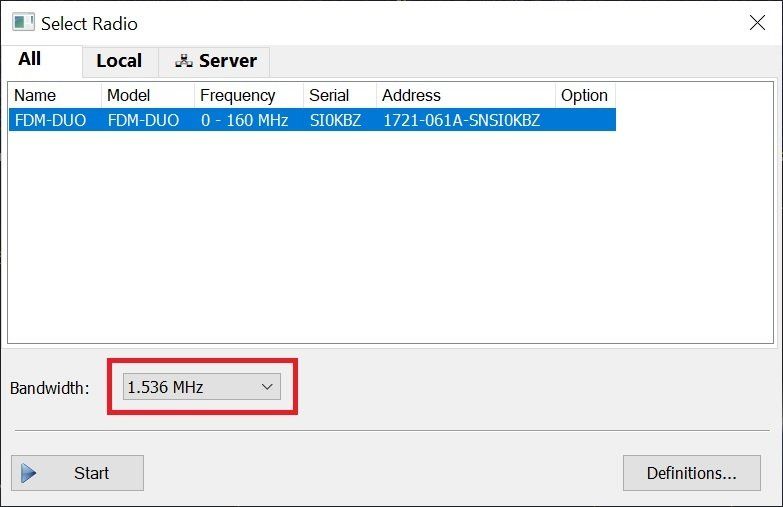

Start the DUO with the 1.536 MHz bandwidth, this is best for lowest receive latency. Read the rest of the description on this page to properly operate the DUO.

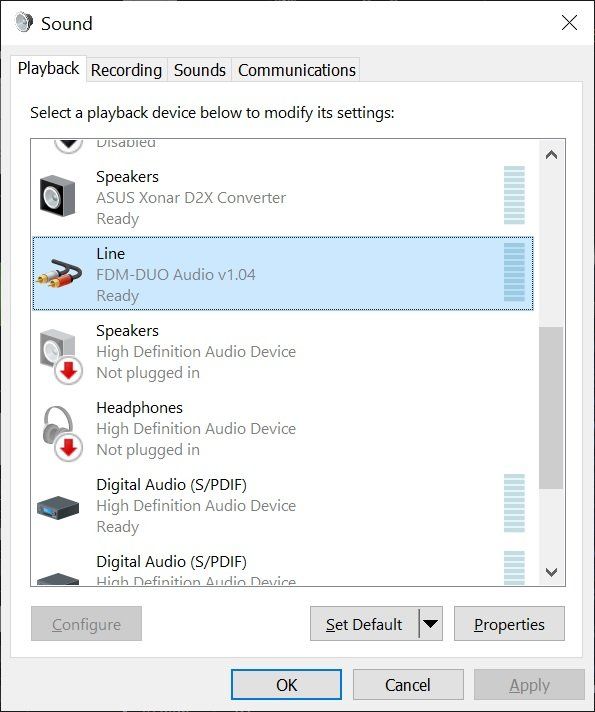

When you connect the FDM-DUO to your computer a playback sound device FDM-DUO Audio v1.04 is added, this is used by SDR Console to send IQ (transmit) data to the DUO. The device properties must be configured as below.
ELAD Menu
  • Elad menu item 30 TX Enable must be set to on.

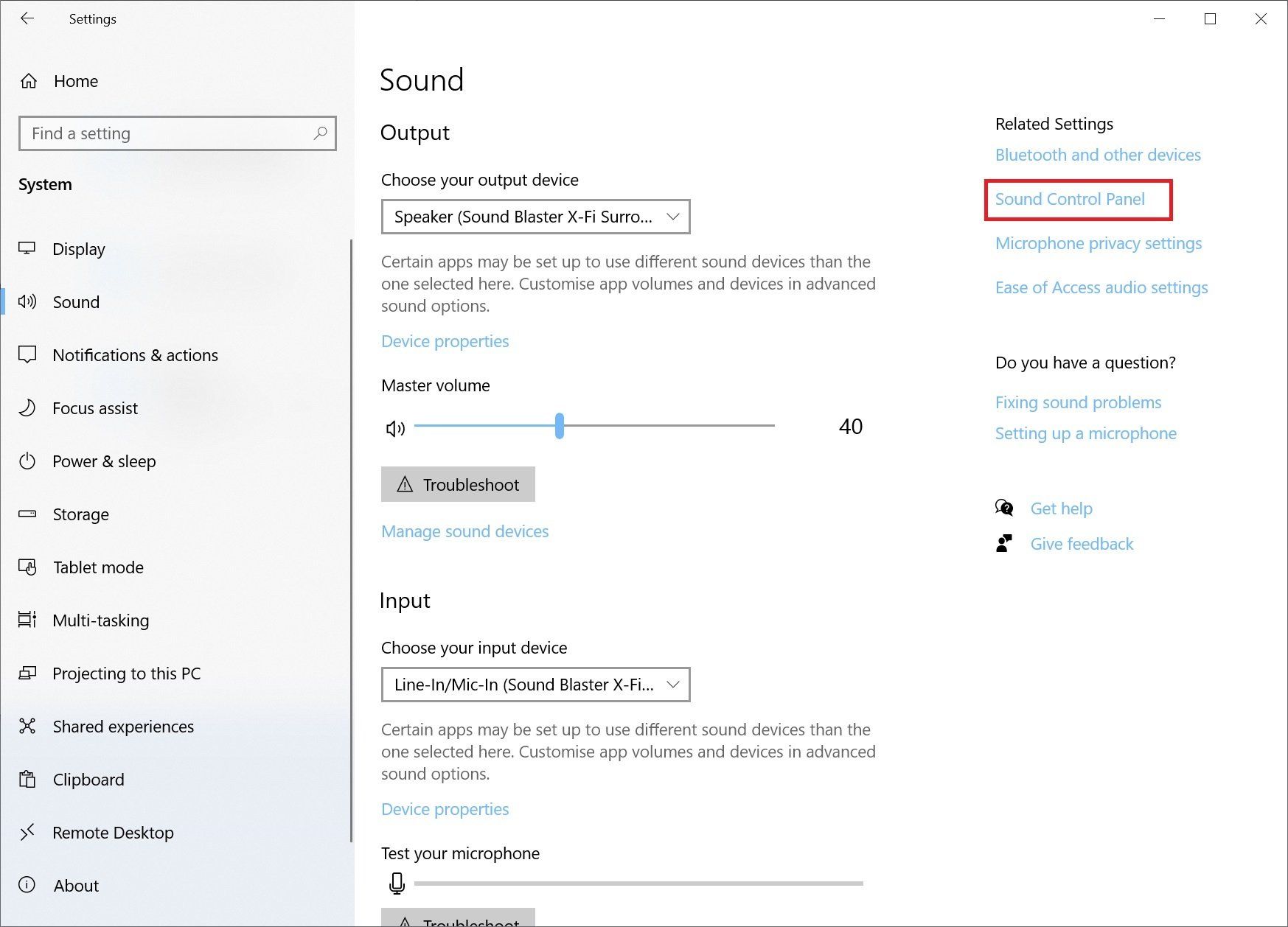

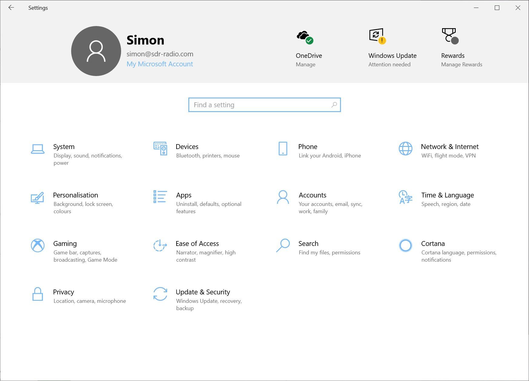

Open The Sound Settings
  1. Open the Windows settings,
  2. Either select System, Sound or enter Sound in the Find a Setting field,
  3. In the Sound window select Sound Control Panel (highlighted).
Default Device
If  FDM-DUO Audio v1.04 has been selected as the default output device then you must select another device as the default output device.

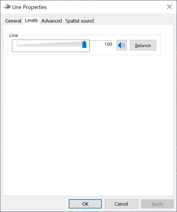

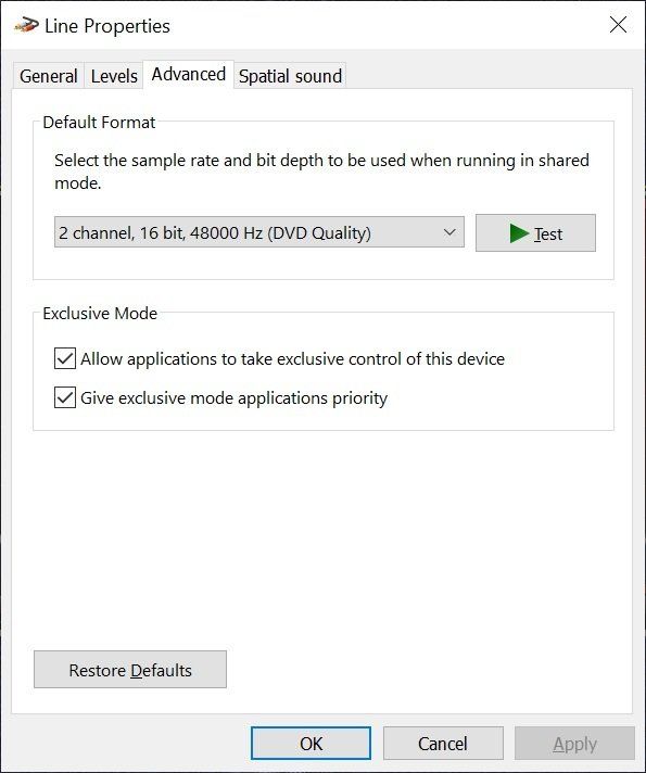

Device Properties
In the Sound Control Panel:
  1. Open the  FDM-DUO Audio v1.04 properties (double-click on the entry).
  2. Select Levels , make sure the value is set to 100 (maximum).
  3. Select Advanced and make sure the default format is:
  • 2 channel,
  • 16-bit,
  • 48000 Hz (DVD Quality).
  1. Select Spatial sound and make sure the selection is set to Off .

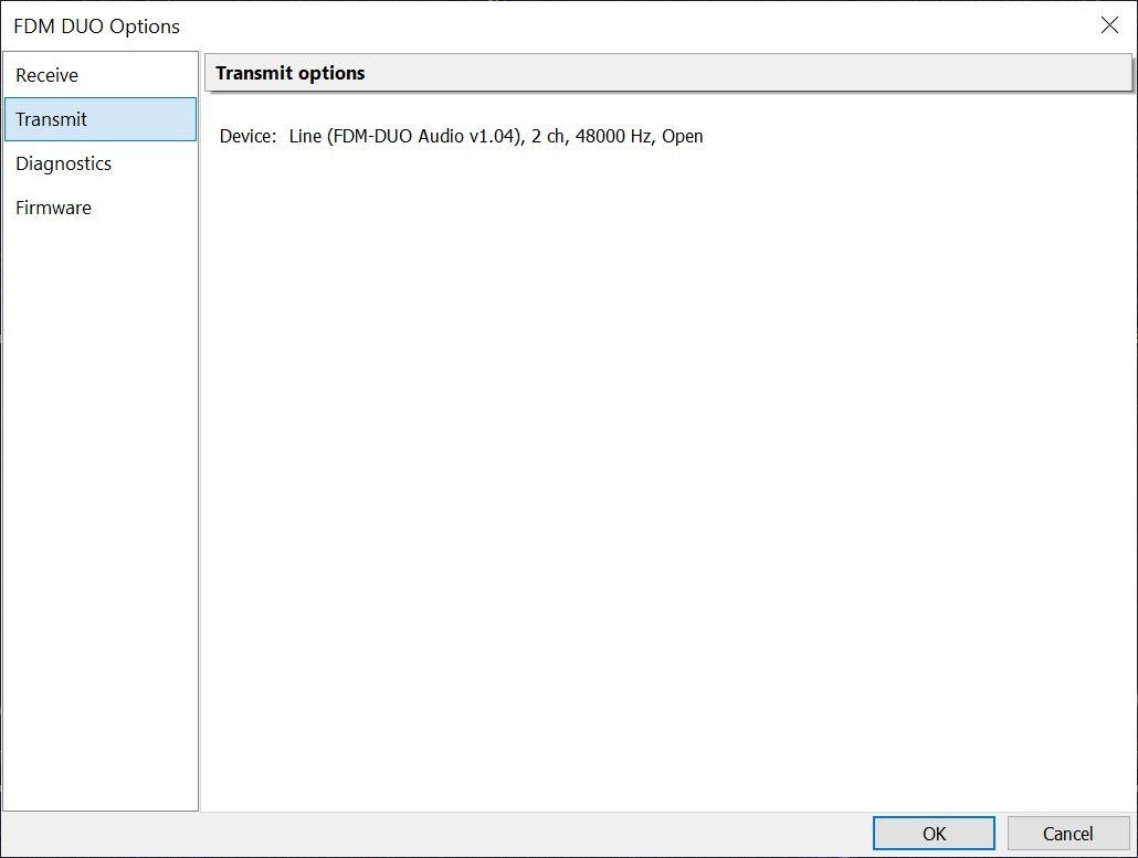

Confirm that the device has been opened:
  1. From the Console's Radio panel click Options, this opens the FDM DUO Options.
  2. Select then Transmit page.
  3. Check the device is shown as open.
Make sure the USB audio device (above) is correctly configured with the Level set at 100.

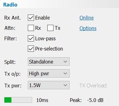

The main options are selected from the Radio panel.
  • Rx Ant Enables a separate receiving antenna, connected to the SO259 RX connector.
  • Attn Enable attenuation of the received signal, Tx enables the attenuator while transmitting.
  • Filter Enable a low-pass and/or pre-selection filter.
  • Split Always set to Standalone (will be removed in a future kit).
  • Tx o/p Use either the SO259 RX/TX connector (max power 10W) or the SMA RF connector (max power 0 dBm, 1 milliwatt).
  • Tx pwr Maximum output power when High pwr is selected.
The transmit indicators at the bottom are
  • TX Overload,
  • FIFO size in milliseconds,
  • Input level, value is shown in dB relative to the theoretical maximum.

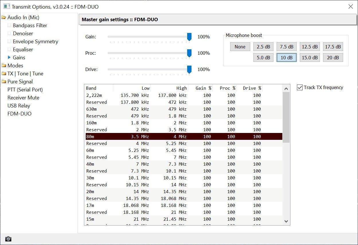

Common

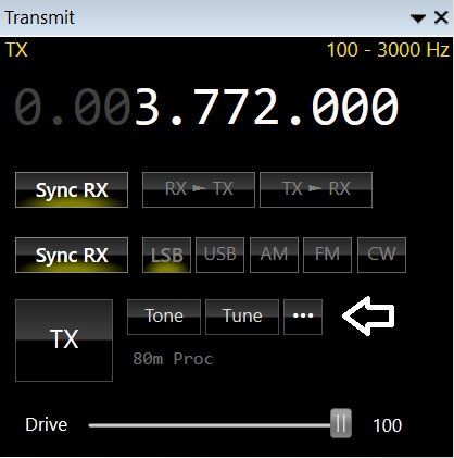

See also the common Transmit options. Select Transmit options either by pressing ••• in the Transmit pane or by selecting Options from the Ribbon Bar, Transmit pane.
Shown below:

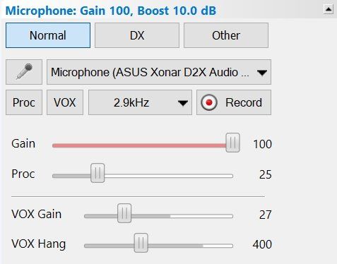

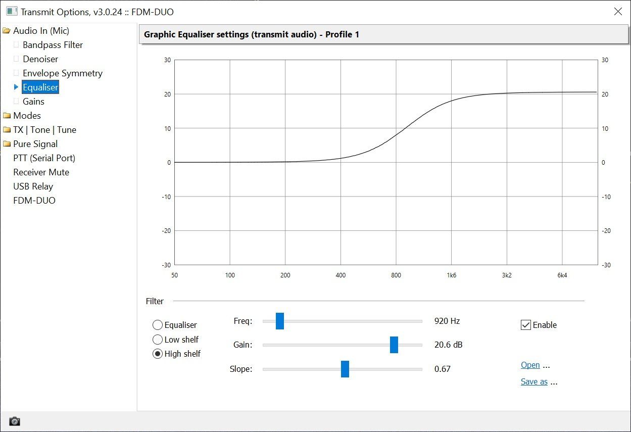

  • Master gain settings, you may need to boost the microphone by up to 20 dB, typically only 10 dB is required.

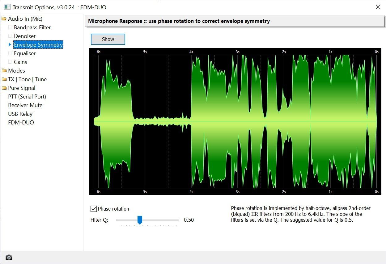

  • Envelope symmetry, normally the output from a microphone is not 100% symmetric
  • Equaliser, shown here is a high-shelf filter which boosts the output above 600 Hz.

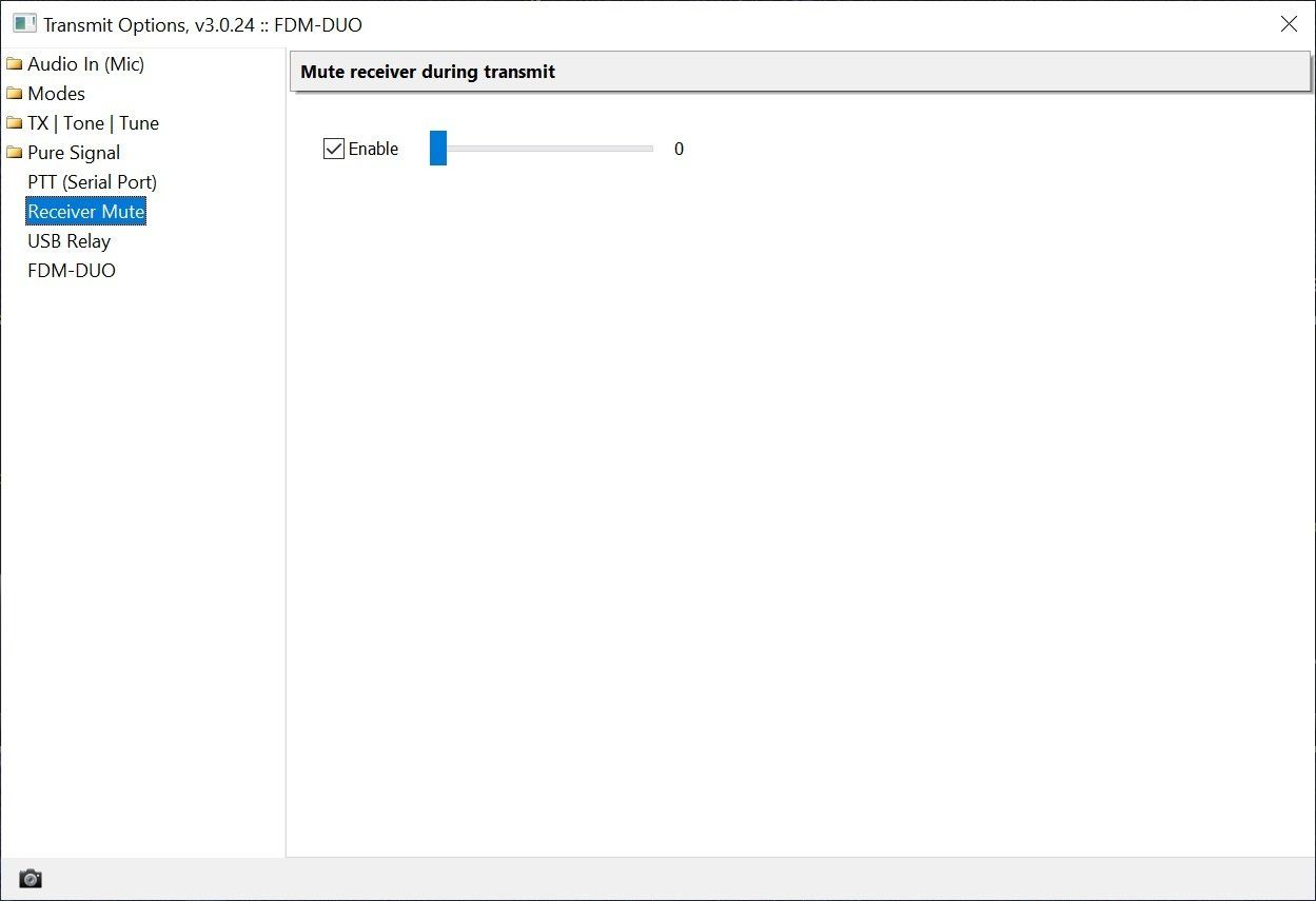

  • RX Mute, this mutes the receiver while transmitting as the DUO runs in full duplex.

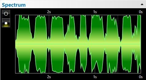

Microphone

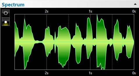

When you select a microphone the output is shown in the Spectrum window.
In the example on the right the level is good without any extra processing, adding processing increases the output level, too much processing will result in distortion.
You should be able to modulate well without adding extra processing, if the level is too low you can boost the output by up to 20dB (see Gains, above). Adding Equalisation will also boost the output.

The recommended bandwidth is 1.536 Mhz, this has the lowest latency and enough bandwidth for most ham bands.
