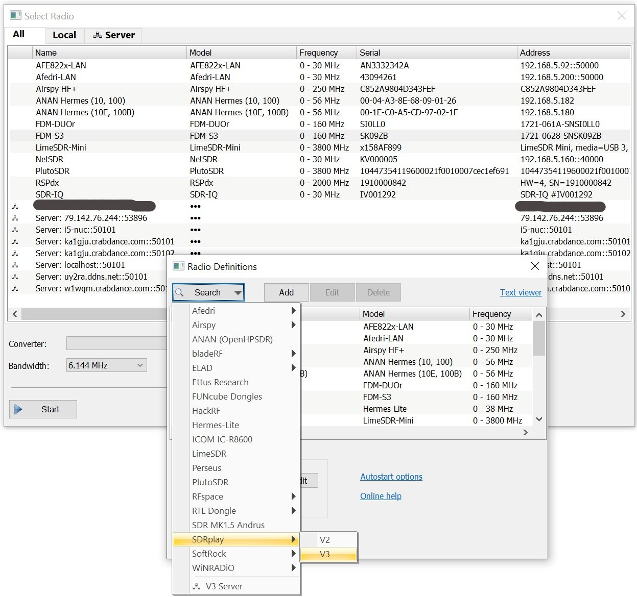

Selecting V2 or V3
The version 2 (old) and version 3 (new) implementations are independent, the image below shows the selection option. When you select either version 2 or version 3 a search is made for all SDRplay devices (RSP1A, RSPduo, ...) connected to your computer.
Version 3 is recommended.

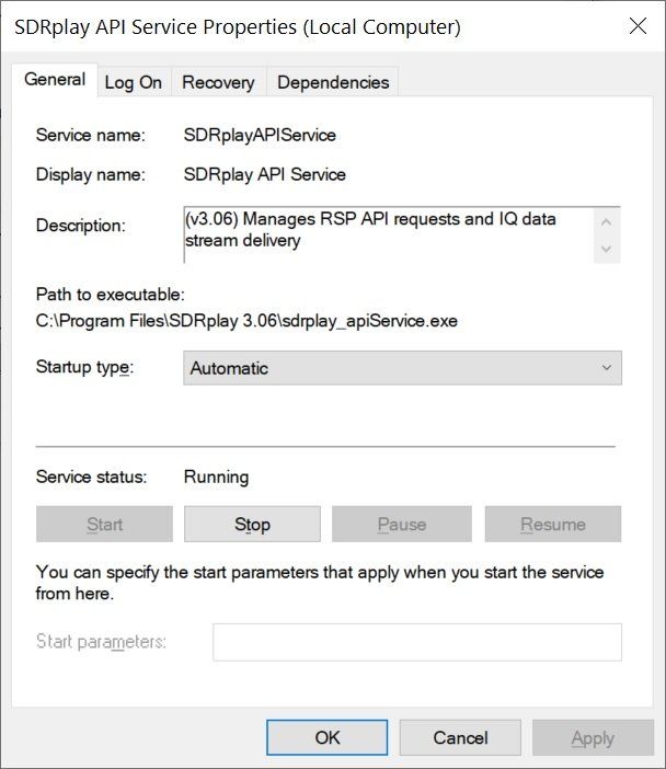

SDRplay API Service Disabled
When you install the SDRplay support software a service is created which is set to start automatically when your computer starts.
If you use AVG Tuneup you may find the service is disabled, so configure AVG Tuneup so the service is not changed.

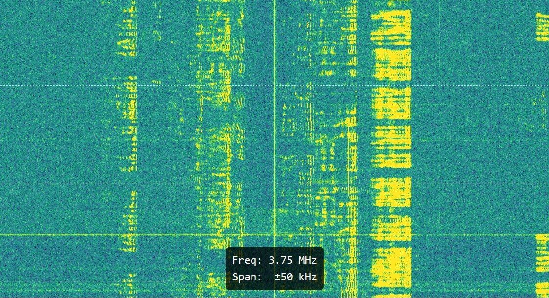

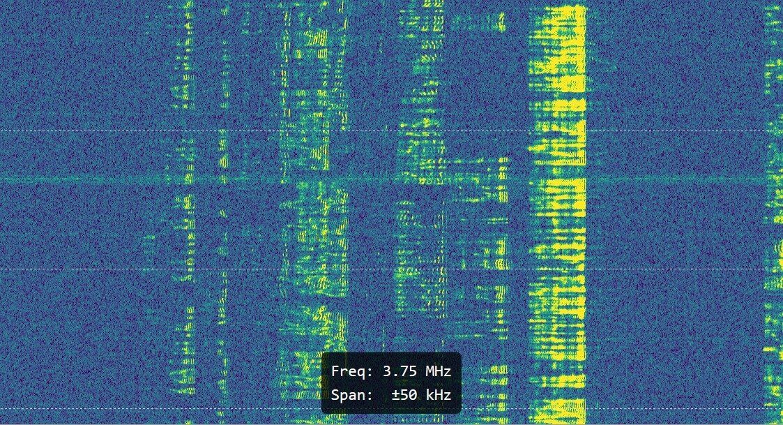

For best performance use a bandwidth of 2.048 MHz or lower. Bandwidths greater than 2.048 MHz have a spur in the centre of the display which is generated by the SDRplay hardware and cannot be eliminated. If you listen to a signal in the centre with a bandwidth greater than 2.048 MHz the audio will be distorted and have many unwanted artefacts.
Also, lower bandwidths require less data to be processed, so the CPU load on your computer will be reduced.
Spur
Here is an example of the centre spur at 3 MHz bandwidth compared to 2.048 MHz.
