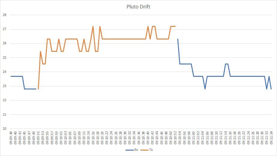

Measuring
When starting Pluto an extra pane is added to the receive DSP with the current temperature. 24 hours' data is available via the Download button. The format is CSV which can be opened with programs such as Excel.
An example of a chart which you can create with Excel is shown below.
